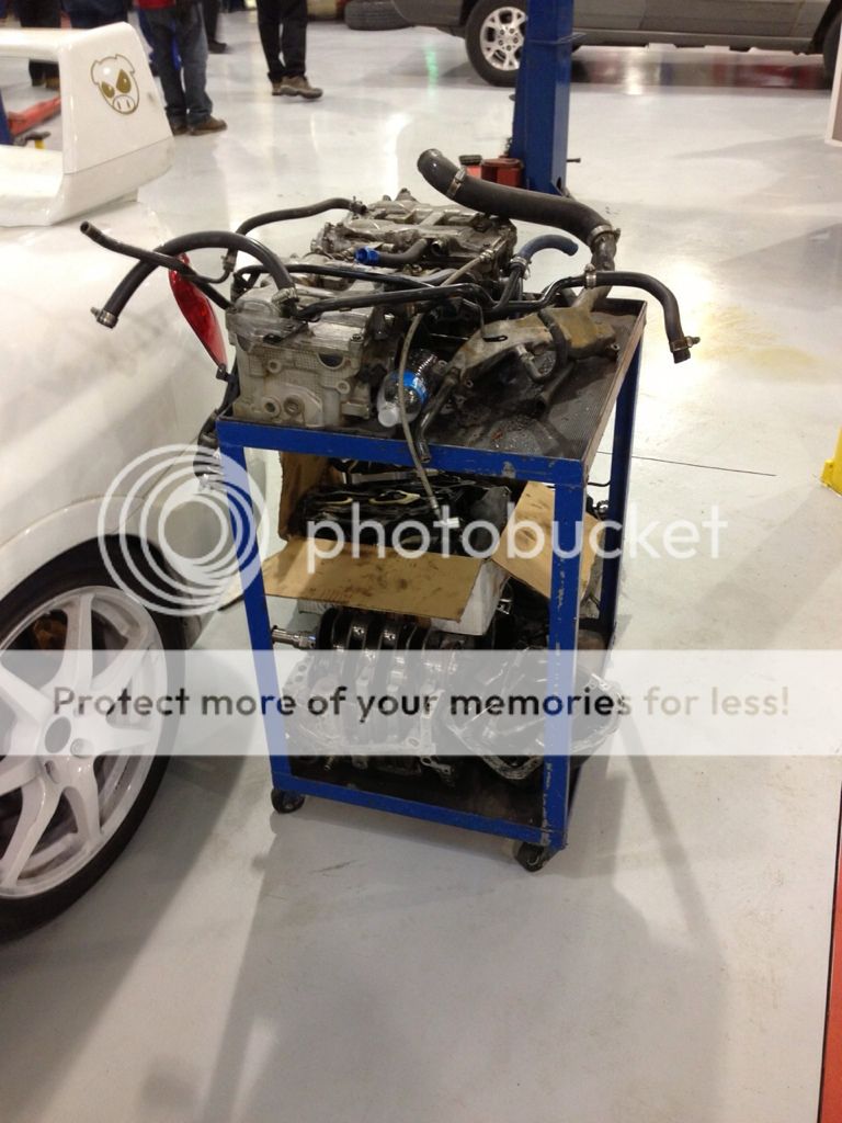

As all of you know, my STi went down a couple months back due to a bad knock and one of the cylinders leaning out and melting. That was caused due to a bad PCV valve and so the oil came splurging out of the dipstick when I was on 54 South. Anyways, I decided to go ahead and rebuild her again so I will start adding pictures of the process as well as some updates as to what gets removed, replaced, etc….
So far we have already deleted the Air conditioning components and the ABS module and lines. Rigo has started the wire tuck as well. Notice the fuse box new mounting location.

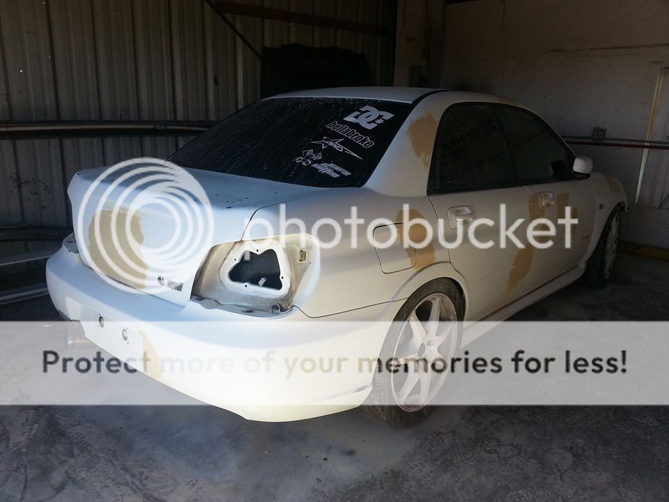

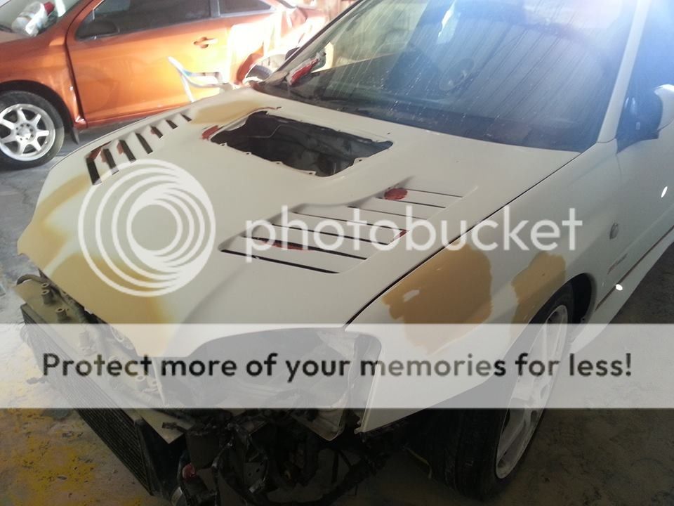

Got picked up for sponsorship by Buddy's Body Shop on Alameda. They are doing the body work, tucking/shaving of bay, and all paint work. I have been over to the shop a few times already and they do really good work and the owners / employees are down to earth. Here are a few pics of what they have accomplished so far.
I'm also having them install my brand new spec c roof vent that I picked up from a guy located in Japan. This will hopefully help out with cooling since I deleted the a/c and heater components.

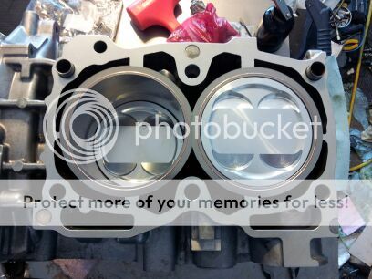

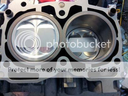

As far as motor work is concerned, the motor is almost completely finished and ready to be dropped in upon completion of the paint work. I have a few bolt on pieces that I need to pick up before she will be 100% compete, however here is a list of the stuff I decided to go with:
Brand new Sleeved/O-ringed EJ257 Block w/ 100 mm CP 9:1 Pistons
Manley H Beam Plus Rods
OEM Nitrated Crank
ACL Race Bearings (Main & Rod)
Modified Oiling

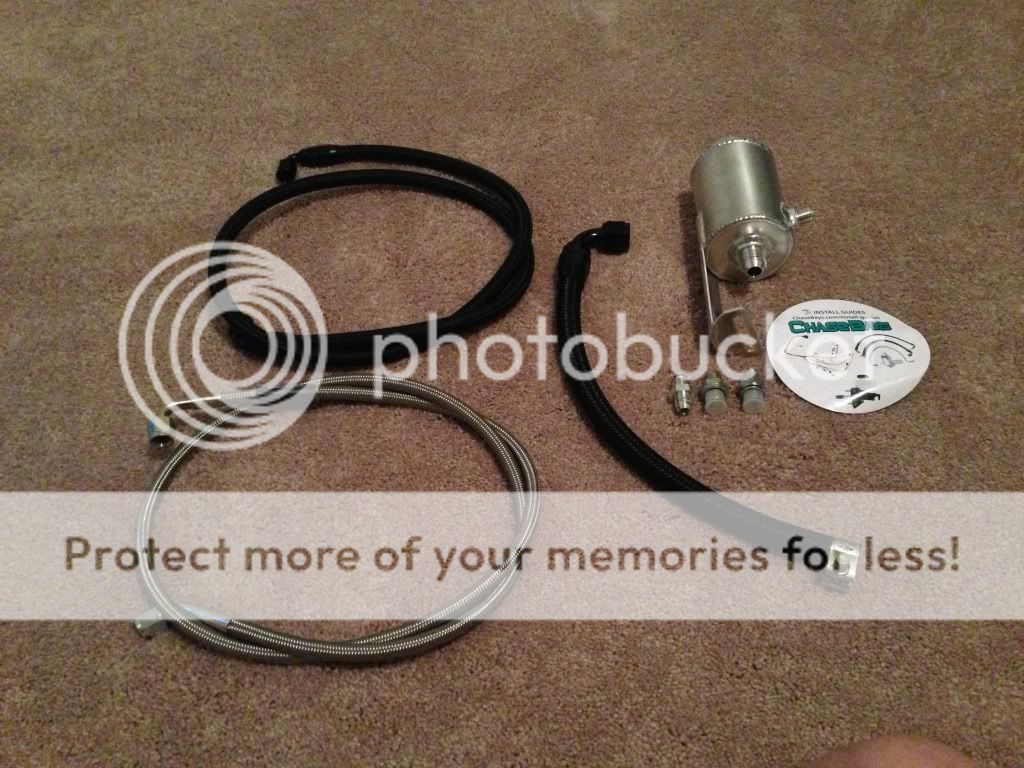

I also decided to do a few cosmetic mods as well as picked up a sponsorship from ChaseBays. I'm now going to run their Brake Booster Elimination Kit, In Dash Brake Line Relocation, as well as their Power Steering Kit.
