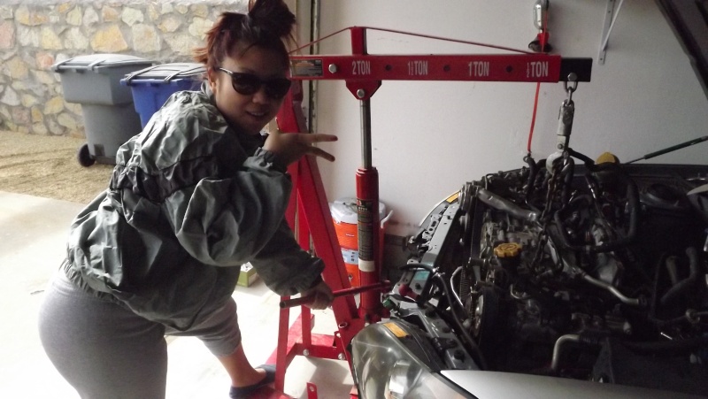

My wife puttin in some work. She helped me the whole time, Thanks baby!

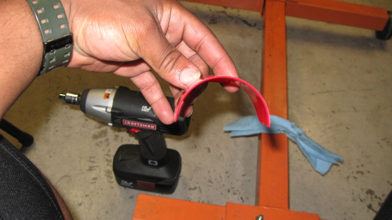

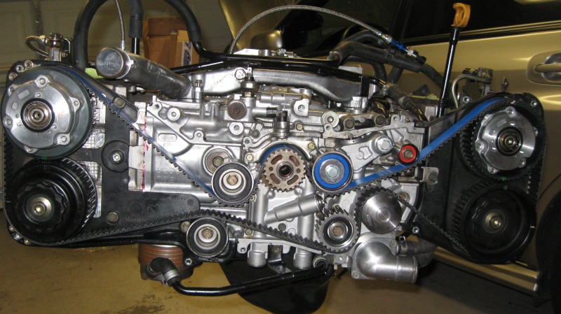

So here is the Gates Racing belt kit w/ water pump installed. All the bearing looked great and it even came with a spacer for the belt guides. There's only 2 things i didnt like about it, both easily fixed. One, the bolt hole just above and right of the pulley on the water pump was not flat all the way around for where the bolt tightens down' easy fix with a dremel and a sanding drum. Two, the WP gasket that came with it was paper and just seemed flimsy so i just cooper coated and reused my metal one. Other than that im totally happy with the kit

This is the spacer that came with the gates kit. made life easy when gaping all the belt guides.
