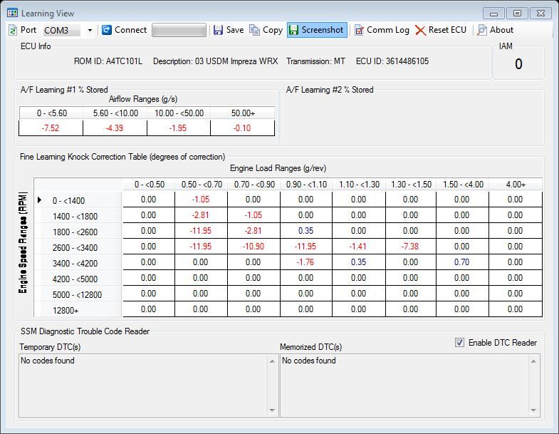

Chaz2.5 wrote:What made him think there is an engine issue?
I told him I was getting knock and showed him this screenshot of my ecu's learning view. He replied with "That is MASSIVE knock and misfire. The engine probably has mechanical problems"

Pending on the knock and when it happens/ how much is being picked up, it can be linked to just needing a tune. Case in point, when my 08 was tuned by Sean @ RalliTEK I was picking up some knock. Sent him the logs and the tune just needed to be tweaked. Got the updated map and the knock was gone.
How much knock was on your logs? Was it under load? idle? cruising?

below is the most recent learning view I pulled from the car unfortunately this is from 2012. As you can tell the IAM is at 0 and its still cutting back 11.95 degree of timing.

camron_25rs wrote:below is the most recent learning view I pulled from the car unfortunately this is from 2012. As you can tell the IAM is at 0 and its still cutting back 11.95 degree of timing.
That's rather erratic the amount and way it's pulling timing. You're not by chance able to pull timing and fuel maps are you?
