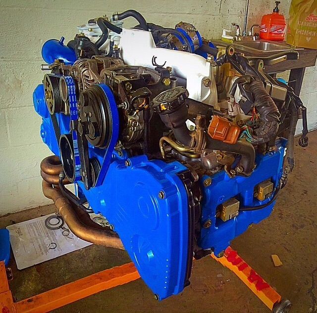

Post by ER04STi on Wed Jan 30, 2013 2:36 pm
...:UPDATE:....
So it's almost been two years so it's time to follow up and edit this thread...
I ended up getting the short block built by True Street Industries in El Paso and they brought it down to Phoenix once done. The heads were machined and assembled by Car Parts Machine Shop in El Paso so all I had to do was throw the heads on and drop in the engine.
Starting with the mod list:
Manley 100mm pistons
Manley I-Beam rods
ACL main and rod bearings
Killer B oil pickup
11mm oil pump
GReddy oil catch can
GSC 272 camshafts
GSC +1mm valves
GSC Beehive valve springs
Cometic head gaskets
ARP head studs
TGV deletes KSTech block off plates
Gates timing belt and kit
Gates a/c and alternator belt
Cobb crankshaft pulley
Fujita intake
Agency Power Turbo inlet
Forced Performance td06 20g
Walbro 255lph fuel pump
Modded side feed 900cc injectors
As of two weeks ago, the whole car was completely done and tuned through IA Performance. Unfortunately after 120 miles, I started hearing some internal noise so I took it to RA Worx/Snail Performance out here in Phoenix to get checked out. Turns out there was too much RTV used while assembling the case halves so it got into the oil galleries...long story short I need a new crankshaft, bearings obviously, and a new block (or sleeves Twisted Evil )
Also here is a clip of the car when I first fired it up Laughing
http://instagram.com/p/tGNG5zkE6Q/

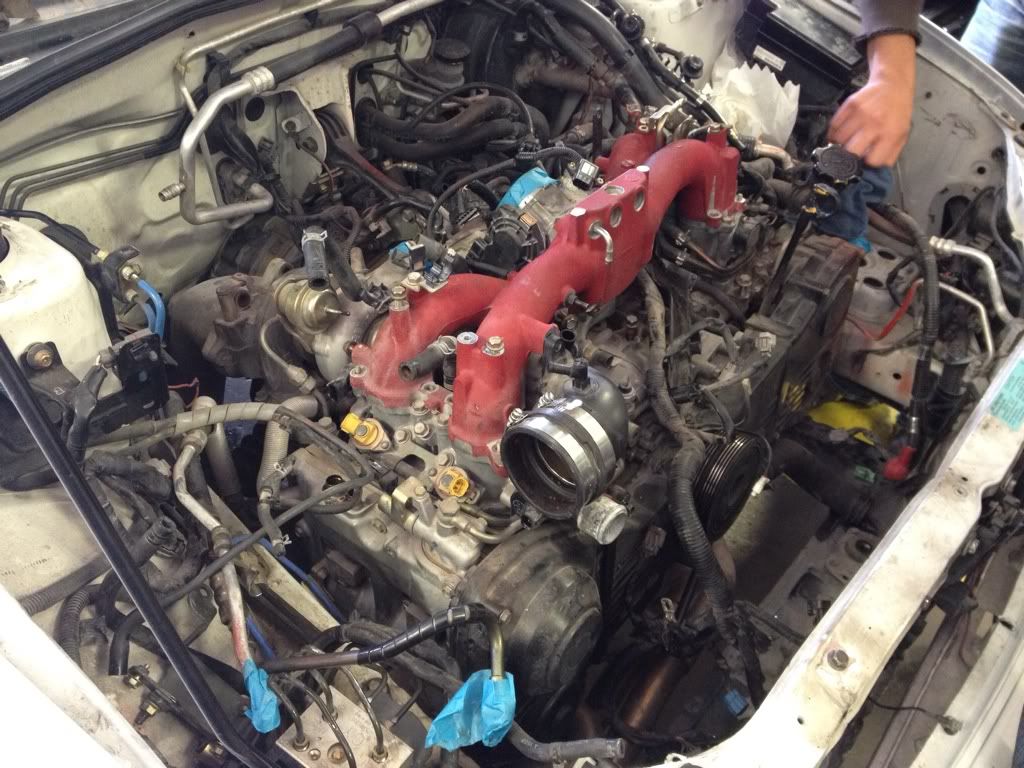

Post by ER04STi on Wed Feb 06, 2013 9:08 am
Here's some pics of Mondays progress, continuing on it today.
[img][/img]
[img][/img]
[img][/img]

Post by WANTED on Wed Feb 06, 2013 5:26 pm
Just hurry up and yank that mess already. Worst case scenario, all you need is a chop saw, a scissor jack, and a case of beer to get that crap out of your engine bay. lol!
Age : 103
Re: 2004 STi engine build
Post by ER04STi on Thu Feb 07, 2013 8:44 am
Lol I got it all out yesterday! The thing is I only got 4 hours a day to do it at school so that means rushing all the time & no beer Sad

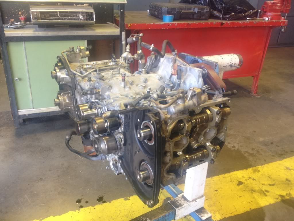

Post by ER04STi on Thu Feb 07, 2013 8:50 am
I'm gonna take some beer in a McDonalds cup Very Happy
Anyway here are the only pics i took yesterday
[img][/img]
[img][/img]

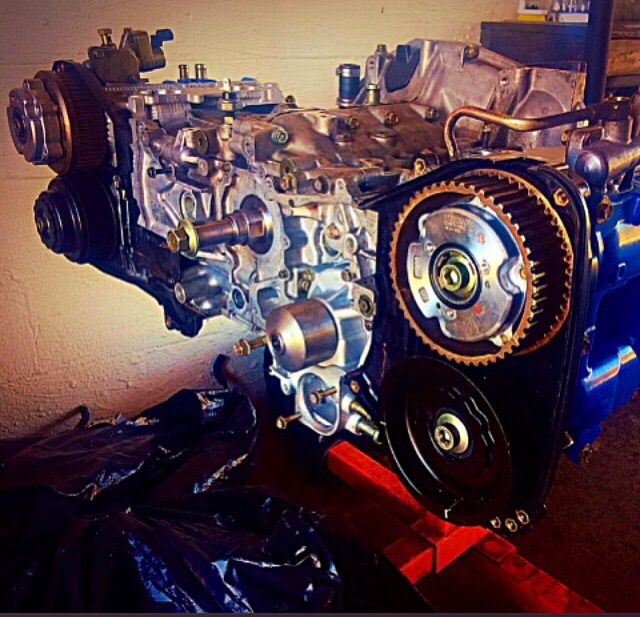

Post by ER04STi on Wed Feb 13, 2013 3:14 pm
So I finally ripped apart the block & found out everything was actually in pretty good condition. Still rebuilding it regardless And probably will be selling so one of the WRX guys can rebuild Very Happy
[img][/img]
[img][/img]
[img][/img]
[img][/img]
