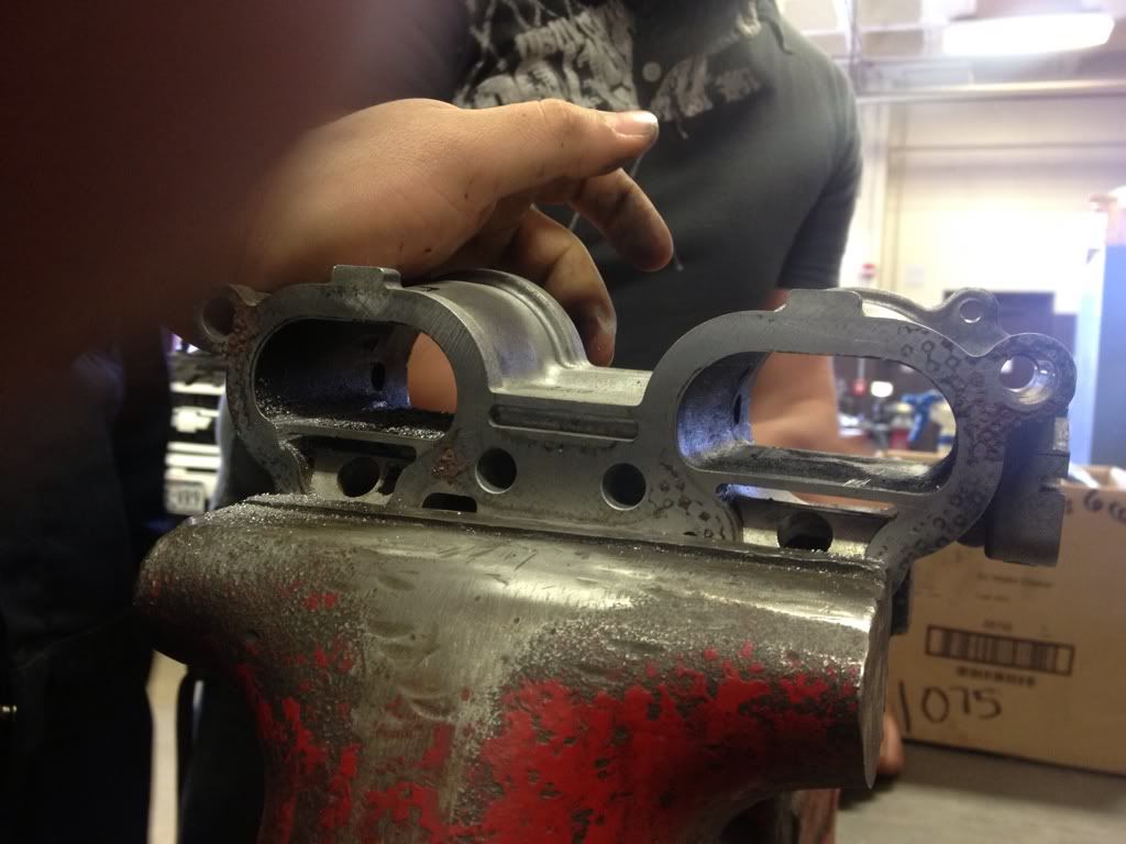

Anyway I took the heads to the machine shop today to check for cracks & start porting/polish along with the tgv's.
[img][/img]

Re: 2004 STi engine build
Don't be scared, man. You can port these easily even if you're only just removing the excess "flap." All you have to be is smooth and steady with the grinder.

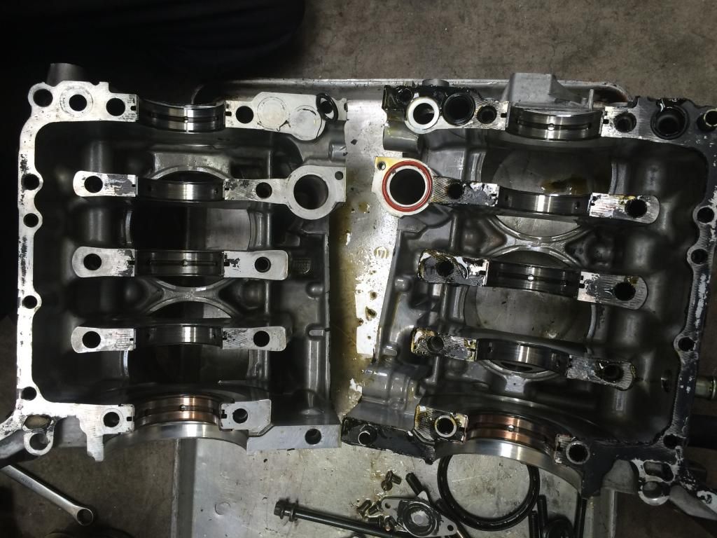

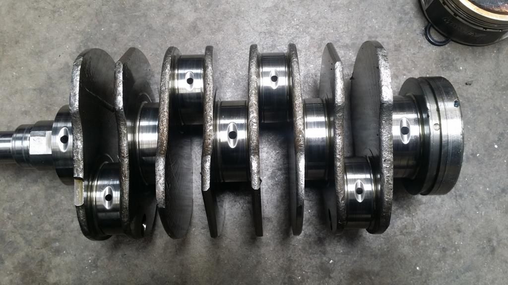

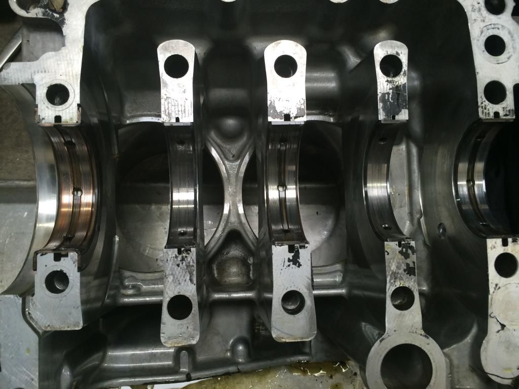

Thankfully none of the internals other than the crank got damaged!
The typical "built" boxer issues. Even the Porsche guys go through this. Good luck, man.

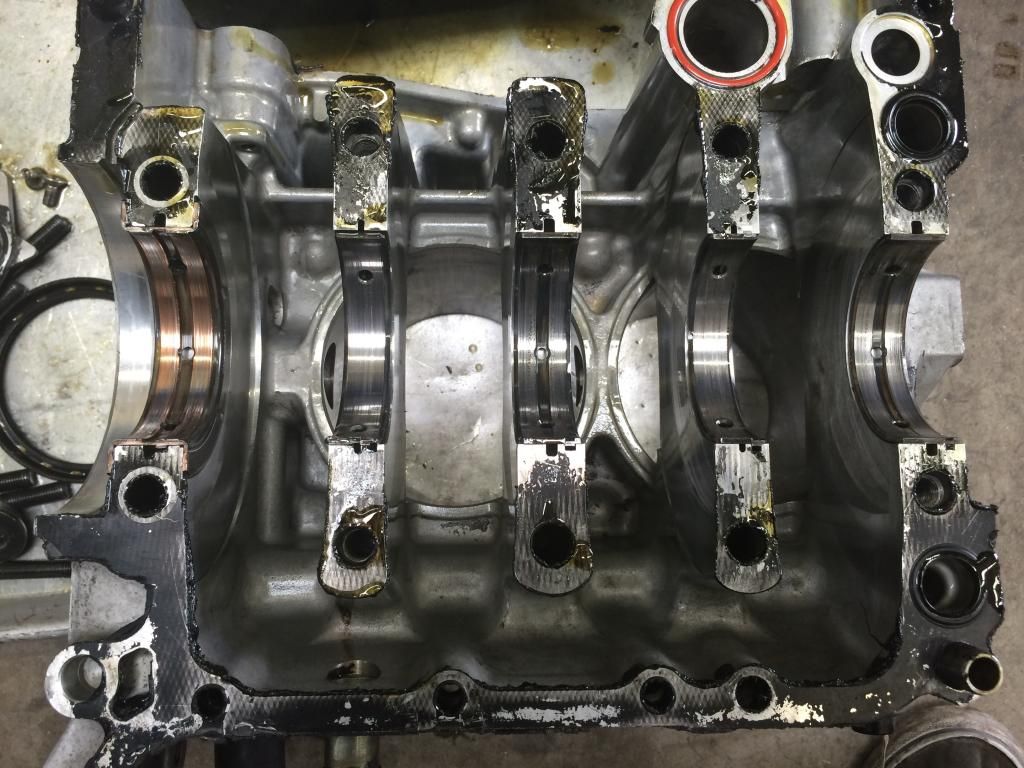

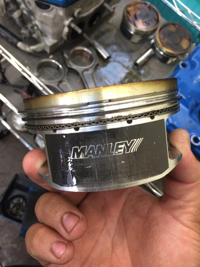

Thanks, I'm still going to try to contact the shop to see if there is any sort of warranty on the assembly since I only got 120 miles out of it.
ER04STi- EPAWD Frequent Flyer
- Posts : 181
Age : 31

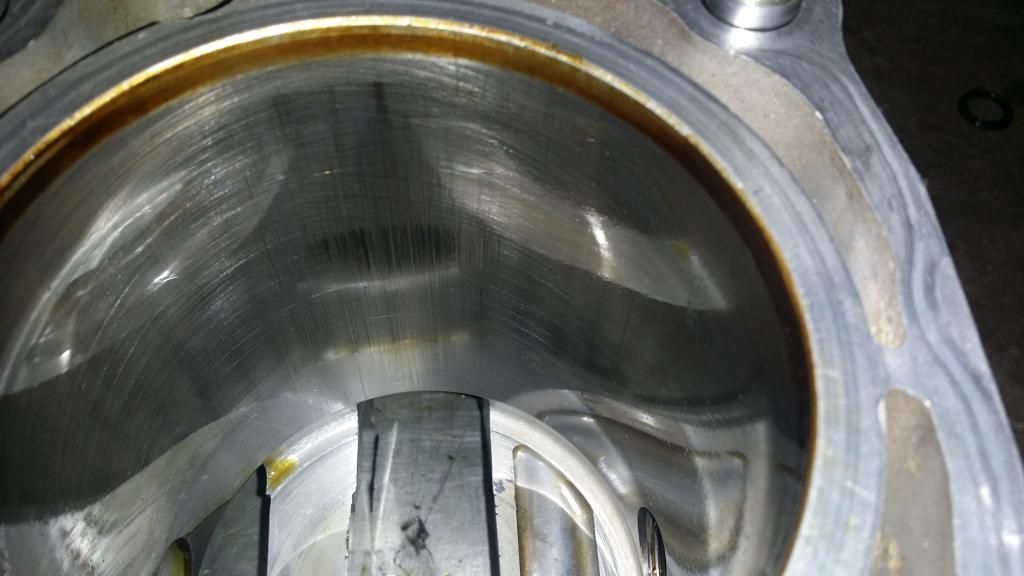

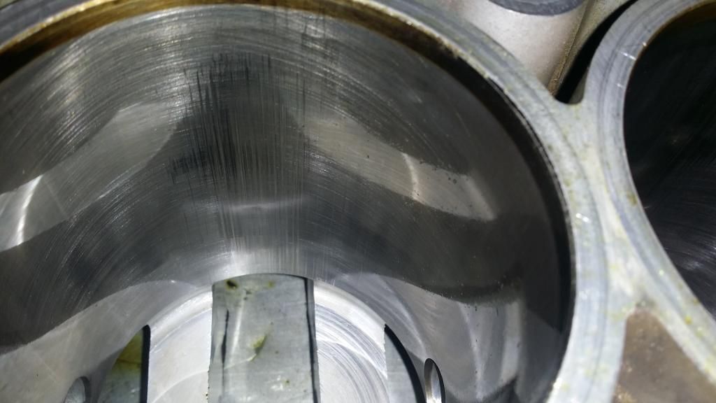

Any pics of the cylinder walls?
WANTED- Forum Outlaw
- Posts : 1479
Age : 109
Here's some photos of the block along with one of the crank
