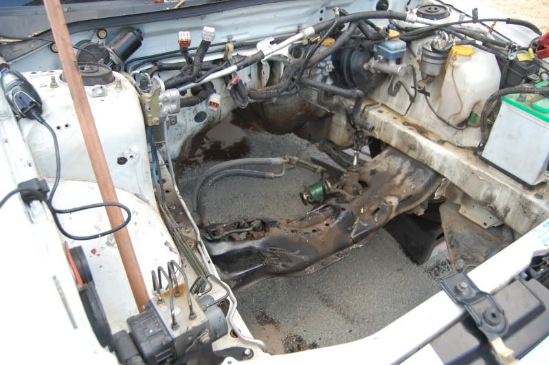

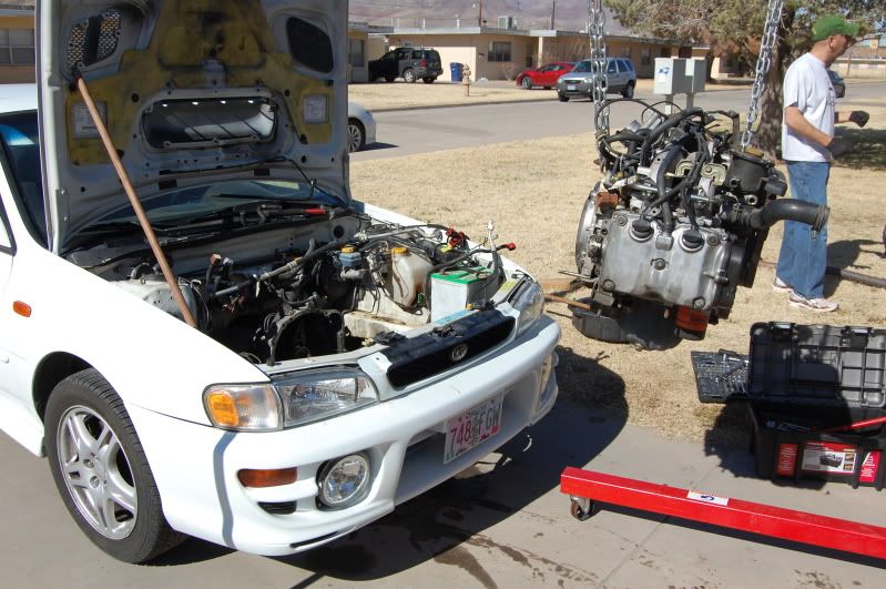

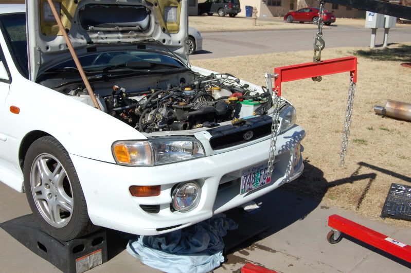

CJ's 99 RS (Alice) Back to the beginning..... something new coming up. DSC_3100

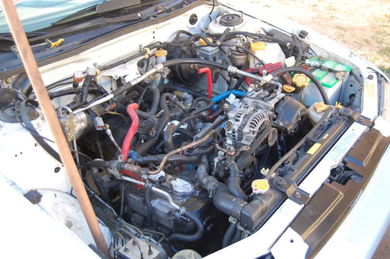

Getting read to pull the EJ253...
CJ's 99 RS (Alice) Back to the beginning..... something new coming up. DSC_3101

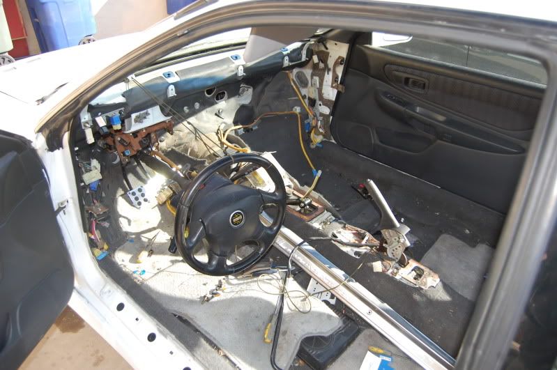

.....and she is out!

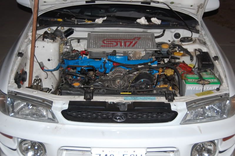

Has a new wrx radiator in it as the original RS blew it's upper seal. Will be replacing the crap aftermarket headers and uppipe with an oem set. Once the A/C is fixed I'm going to be looking at upgrading the suspension.

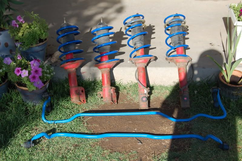

Anyways, sourced my suspension components for now. 07 WRX wagon sways 20 up front 17 rear. Better than the 19/13 stock. Also, have some Prodrive P1 GC springs and KYB AGX struts. Put the sways on this past weekend. Just waiting for the time to do the struts. Debating if I will need some saggy butt spacers.

So, went to install the struts and unknowing to myself the nuts for the strut rods are different between stock and KYB. Drove all over East El Paso and no one carried the correct nut M14 x 1.5. Contacted KYB, told them I had bought some [b]used[/b] AGX's and they didn't come with the nuts. Asked if they have the part #'s, size, and if they sell them separately. Instead of giving me that info they asked what part #'s the struts were and sent me all 4 nuts, free of charge, including shipping costs. Talk about Customer Service and Support! Now, I just need a free weekend again.

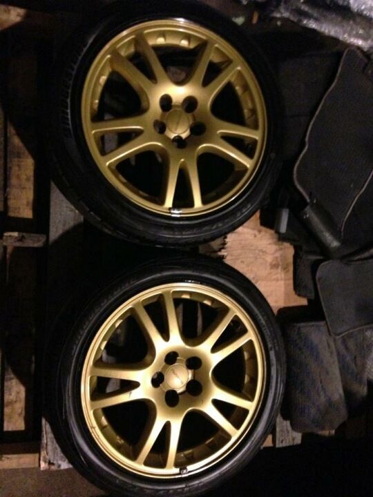

Baby is getting some new shoes....(4 total)
CJ's 99 RS (Alice) Back to the beginning..... something new coming up. IMG950478_zpsbf16e8f5
Since I now have a 68HTA turbo, I got these for a great price by throwing the vf39 in for partial trade. (Sorry Alan)
